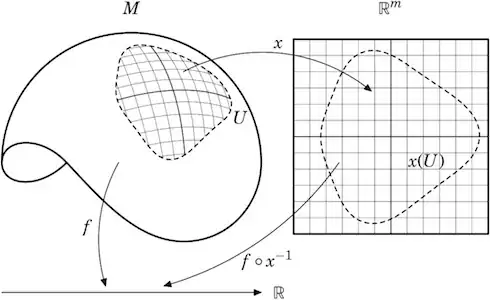

I'll interpret your term diagram as "any fancy image that captures some physics".
For this I can hardly recommend anything else then MetaPost. It's on par with TeX in being a little hard to learn but once you do master the basics you won't believe you could have ever used anything else (in particular, GIMP and Inkscape; good analogy here would be to TeX vs. MS Word).
Basic properties
  1. it's a (simple) programming language
  2. it's vectorial (this should probably go without saying but still)
  3. it's primitives are things like points, lines, paths, splines
  4. it contains excellent image manipulation facilities; you can say things like "take this image, scale it up by two and rotate it by 60 degrees"
  5. you can insert TeX labels
  6. it can solve equations; This is a real killer that no one else offers. You can draw two curves $X(t)$ and $Y(t)$ (defined most comfortably as splines) and tell MP to compute their intersection, draw a point there and label it with some text
Success story
I used MP to create some polygons on a hexagonal lattice in the context of cluster expansions. There was a huge number of those polygons to draw, so I quickly abandoned all hope of trying to draw them by hand in Inkscape or something similar. True, it would probably be quicker in the end, but I hate manual work; I rather spend much longer learning some programming language and then just code all the work in few minutes. So I put together simple MP program that has converted my input data (vertices and edges of the polygons as just numbers) into beautiful images. For a one night's work and my first time with MP I was more than satisfied.
Goodies
alt text
Credit for this amazing picture goes to Johan Kåhrström (go also see more stuff under illustrations there).

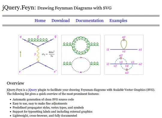

For drawing Feynman diagrams with SVG, I have developed jQuery.Feyn to make it easier (see the screenshot below). enter image description here

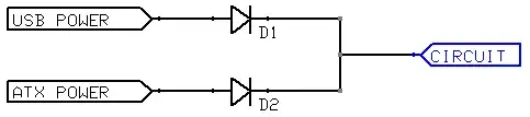

For electric circuits, CircuitLab is a nice online editor and simulator. There are some restrictions to what you can do without an account or with a free account - I can't remember the details - but you can use print-screen to get nice pictures out of it. I like it because it is really at the level of simplicity I need: if I'm explaining a basic electric-circuits question, I do not want to spend more than two minutes drawing, say, five resistors in some parallel/series configuration. CircuitLab gets the job done.
For a tour, see their YouTube video Getting Started with CircuitLab.
Edit: If you want a png output to include in a post on this site, you can go over to Electrical Engineering, which has a built-in implementation in the post editor and simply bring back the image link. Thanks to Chris White for the tip!

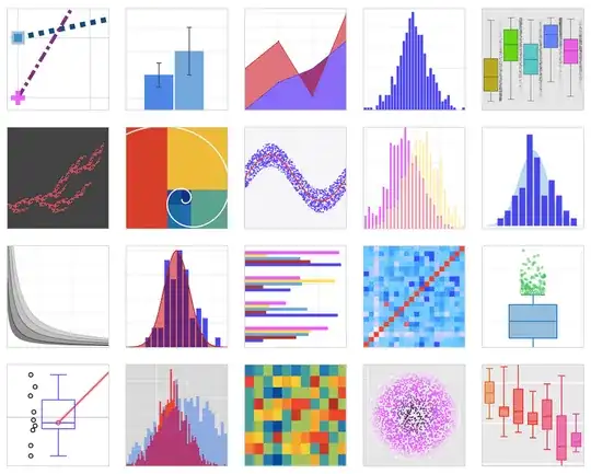

You can also use PLotly, a collaborative, web-based graphing platform with APIs in Python, R, MATLAB, Julia, and Perl. You you can find the code to make these examples in their documentation.
here.
