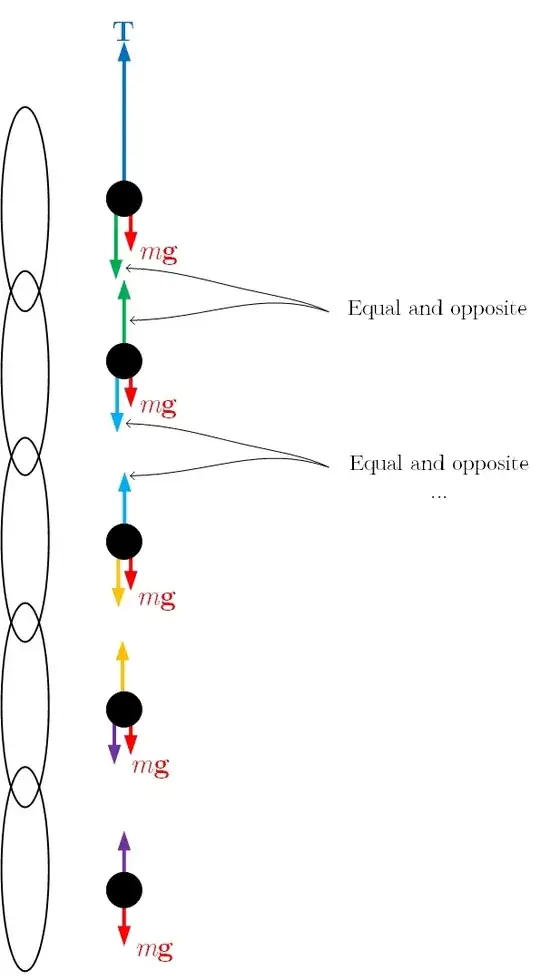

The reason each link will have the same net force is because:
  • Each link has the same acceleration, and;
  • Each link has the same mass.
Since the net force is $\Sigma F=ma$ and $m$ and $a$ are the same for each case, the net force on 1 link is the same as the net force on each other link.
So yes, each link will have a net force of $\Sigma F_\mathrm{link}=T_i-T_i'-mg=ma$ where $m$ is the link mass, and $T_i$ is the force pulling up that specific link (each link will have its own magnitude for $T_i$), and $T_i'$ the force pulling up the link below (Newton's third law action-reaction pair).

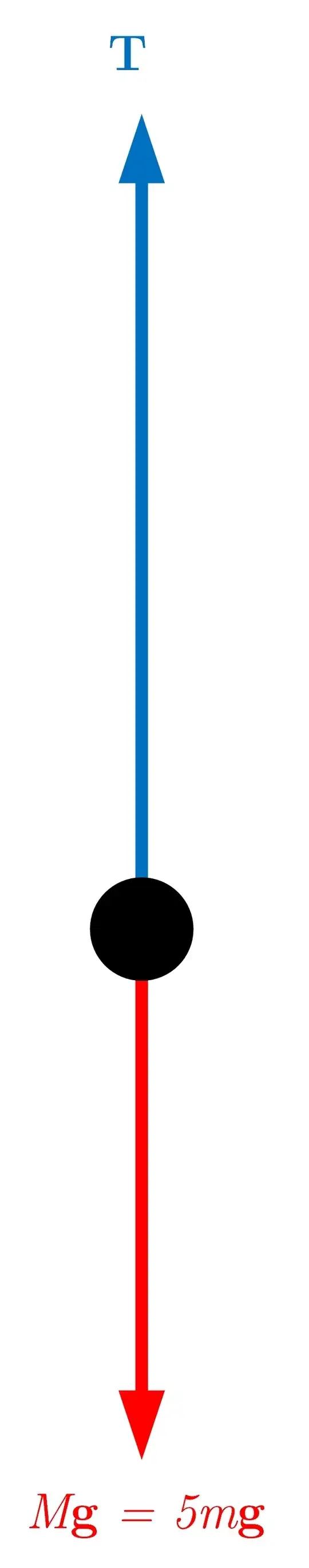

The net force on the system is $\Sigma F_\mathrm{system} = T-Mg$ where $T$ is the upwards force pulling everything up and $M$ is the mass of the five chain links, $M=5m$.
The net force of a link is $\Sigma F_\mathrm{link}=T_i-T_i'-mg$ where $m$ is the mass of 1 chain link and $T_i$ is a force pulling up that specific chain link (different for each chain), and $T_i'$ is the force pulling up the link below.
The following FBD should clear it up:
You can also calculate the net force on the system, namely:
