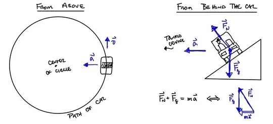

In this problem we assume the kinematics: The car travels at constant speed on a banked curve and its trajectory makes a horizontal circular path, implying that the acceleration vector is also horizontal and points directly into the center of the circle.
If there is no friction on the banked curve then the only forces are gravity and normal and Newton's Second Law tells us that: $$ \vec{F}_N + \vec{F}_g = m \vec{a} $$ Drawing this as a vector addition, the normal force will lie along the hypotenuse of a right triangle with $m\vec{a}$ horizontal and $\vec{F}_g$ vertical:
car on circular banked track
So we see that the normal force being larger than gravity is a consequence of our requirements about the kinematics of the car: because the acceleration points horizontally inward, the normal and gravitation forces must sum (as vectors) to a horizontal vector.

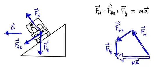

If there is static friction acting on the car, then it is easy to see that the normal force will still be larger than the gravitational force:
car on banked curve with friction
Now, to your questions: What is the source of this normal force? Why is it larger than the weight? The source of the normal force is simply from contact with the road. Its magnitude is that which is required for the car to remain on a circular path. The statement about circular motion is: "if an object travels on a circular path, then it has an acceleration that points inward with radial component $v^2/R$." So the normal force has the necessary magnitude to get the assumed inward-pointing acceleration. We started the problem by assuming that the car was traveling on a horizontal circular path. Therefore the acceleration points horizontal and inward. And therefore, by Newton's Second Law (demonstrated in the vector addition above), the normal force must have that relation to the gravitational force.

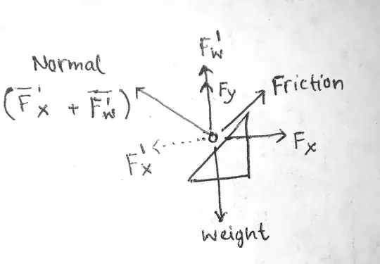

There are many elaborate answer available already but I think you are doing fundamental mistake in your question, you are thinking that one component of force is balancing the weight and other component is providing centripetal force it's not really correct! It's friction which is very important here!
fbd
Normal force is reaction force it can't be there without action forces ! Now what are action forces in this scenario? The weight of body and friction between it and road. The friction is acting along the inclined plane, it's one component Fx is along x axis and other Fy along y axis. Weight is solely along negative y axis. Let's assume some normal force balancing the net force. The normal force has two components F'X along negative x axis and F'w along positive y axis. The Fy and F'w should add up to balance weight and F'x should be equal to Fx. So we have magnitude and direction of normal force if we equate the forces.
From doing vector addition you can confirm that why normal force is greater than weight (weight is contributing just one component of normal force so obviously it's going to be smaller than net!)
