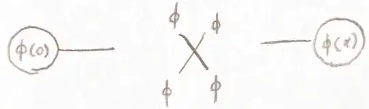

Now, let us consider the expansion via Wick's theorem of the order $\lambda$ term $$\frac{\lambda}{4!\hbar}\int\text{d}^Dy\langle\phi(0)\phi(x)\phi(y)^4\cdots\rangle_G$$. The first term has no contractions $$\frac{\lambda}{4!\hbar}\int\text{d}^Dy\langle:\phi(0)\phi(x)\phi(y)^4:\cdots\rangle_G.$$ We can represent this with the following Feynman diagram enter image description here As before, all external legs are normal ordered. We also see that the external legs coming from the vertex do not carry propagators. This vertex contributes at order $\hbar^{-1}$ and has no divergences as $x\rightarrow 0$.

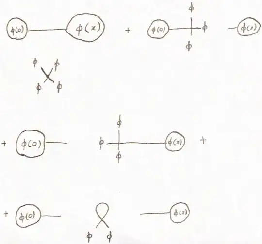

There are 4 terms coming from having 1 contraction, which are represented by the Feynman diagrams enter image description here All of these contribute at order $\hbar^0$ and only the first diverges as $x\rightarrow 0$. However, this divergence is in a certain way already captured from a term at order $\lambda^0$. In fact, we can resum all of the terms with this divergence $$\langle\phi(0)\phi(x)\rangle_G\langle:e^{\frac{\lambda}{4!\hbar}\int\text{d}^Dy\phi^4}:\cdots\rangle_G$$

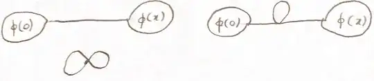

The terms with two contractions are of the from enter image description here All of these contribute at order $\hbar$ and only the first (possibly) diverges as $x\rightarrow 0$ (well, the second one also diverges but we have already discussed these type of terms above). This term is really interesting and it is thoroughly explored in https://pirsa.org/18030064. There is is shown that it does diverge in $D=4$, and in fact, its divergence is of the form $$\frac{\lambda}{2\hbar}\int\text{d}^Dy\langle\phi(0)\phi(y)\rangle_G\langle\phi(x)\phi(y)\rangle_G:\phi(0)^2:,$$ when expanding the external legs around $0$.

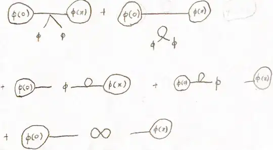

Finally, we have the terms with 3 contractions enter image description here these all contribute at order $\hbar^2$ but only the second has a new divergence. This divergence multiplies the identity operator.
