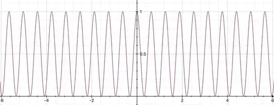

A double slit arrangement with each of the widths of the slits being very, very small produces this interference pattern.
It is a graph of relative intensity (y-axis) against position (x-axis).

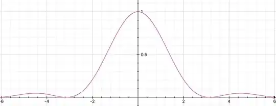

A single slit of finite width produces a diffraction pattern.

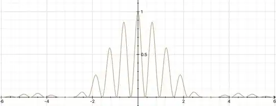

Now if you have a double slit arrangement with slits of the width that produced the diffraction pattern above you get the following interference pattern.
You will note that the single slit diffraction pattern controlled by the width of the slits modulates the intensity of the double slit interference pattern.

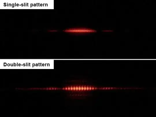

Here is the sort of pattern that you might observe on a screen:

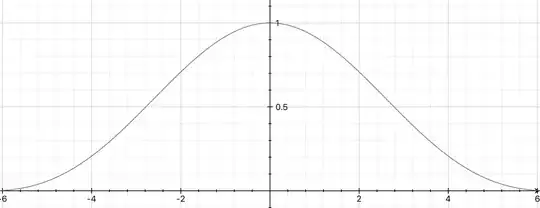

Now if the slit width is halved then the diffraction pattern due to a single slit of that width looks like this.
The diffraction pattern is wider than the single slit diffraction pattern shown before.

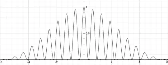

Using two slits of this width whilst keeping the slit separation (centre to centre) the same as before results in this interference pattern.
So you will note that the slit widths control the modulation of the intensity of the double slit interference pattern.
The slit separation controls the separation of the interference fringes.
As the slit separation has not been changes the separation of the interference fringes stay the same.

Update as a result of a comment.
The third graph was produced using
$$y = \left (\dfrac{\sin\alpha}{\alpha} \right )^2 \cdot \cos^2(5 \alpha) $$.
The first term is the diffraction envelope and the second term the interference fringes.
There is more about how the angle $\alpha$ is related to the wavelength of the light, the slit width and the slit separation in this answer and in many textbooks and websites.
