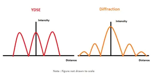

Given below are the graphs of intensity for YDSE and diffraction, clearly you can notice here that for diffraction the central maximum has the highest intensity throughout the distribution, but the same does not hold true for YDSE. enter image description here
