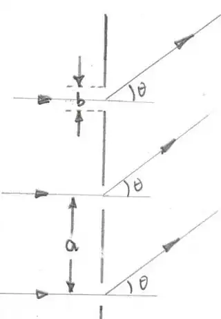

So the diffraction grating can be thought of as $N$ slits each of width $b$ and centre to centre separation $a$.
The intensity $I(\theta)$ pattern for such an arrangement is given by
$$I(\theta) = I_o \left( \dfrac{\sin \beta}{\beta}\right)^2\left( \dfrac{\sin N\alpha}{\sin \alpha}\right)^2$$
where $I_o$ is the intensity at $\theta =0$ produced by a single slit, $\beta = \dfrac {\pi b}{\lambda}\sin\theta,\;\alpha= \dfrac {\pi a}{ \lambda}\sin\theta$ and $\lambda$ is the wavelength of light.

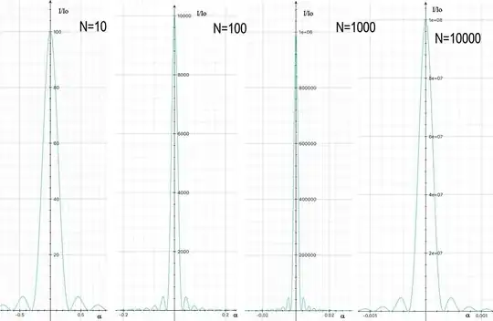

Being surprised by the analysis I took to plotting the intensity function for $N=10,\,100,\,1000,\, 10000$ as shown below.
So it looks as though the analysis was correct.
The next subsidiary maximum is about $2\%$ and so the subsidiary maximum decrease as they get further from the principal maxima.
As an aside the graphs show very well that as the number of slits increases the intensity of the principal maxima increases, look at $I/Io$ scale, whilst the width of the principal maxima decreases, look at the $\alpha$ scale.

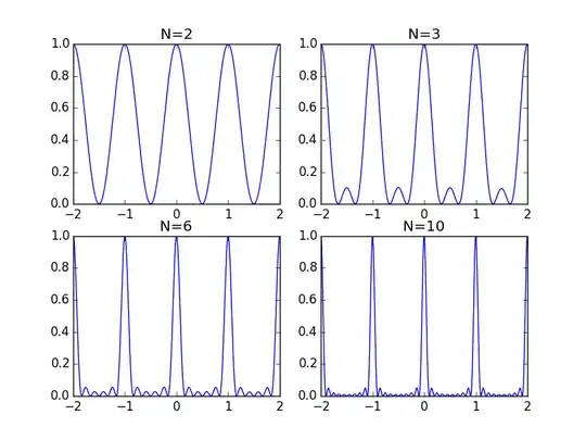

However, when N is not "very large", it will definitely have an effect. The following plots show this:

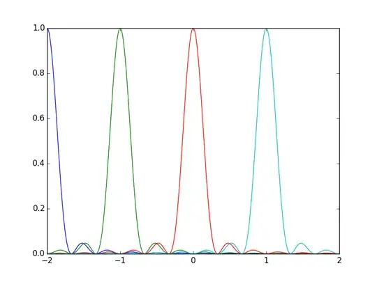

The issue here is that there is a degree of constructive interference between the $n^{th}$ peak of one maximum and the $(N-n)^{th}$ peak of the next one... and even some interference from maxima that are further away. Showing this for just N=3 illustrates this point:
Now as you can see, the secondary peaks are a bit asymmetrical, which makes it hard to find an accurate sum for the general case (the N=3 case is a bit easier because peaks of the same order overlap and cancel the asymmetry).
If you can assume the peak is always at the midpoint between the zeros, you can write an expression for the amplitude - it will be the sum of squares of the peaks that overlap. The function describing the basic pattern is
$$f = \frac{\sin^2{n\pi x}}{(n\pi x)^2}$$
The maxima will happen when $nx = \frac32, \frac52, ...$ so the values will be
$$\left(\frac{2}{3\pi}\right)^2, \left(\frac{2}{5\pi}\right)^2, ...$$
Now a given submaximum will have contributions from all the other maxima - you can see that you would have to construct a series summing the contributions. For the nth submaximum when there are N slits, the first four terms would be:
$$\left(\frac{2}{(1+2n)\pi}\right)^2+ \left(\frac{2}{(1+2(N-n))\pi}\right)^2 + \left(\frac{2}{(1+2(N+n)\pi}\right)^2 + \left(\frac{2}{(1+2(2N-n))\pi}\right)^2$$
in reality, only a couple of terms will need to be included, and only when N is quite small. I will leave it up to you to figure out if you can turn this into a closed form (analytical) sum - but given the (false) assumption of symmetry I don't think it's worth the effort.
Evaluating this exactly (from the convolution), the values for the max of the first secondary peak as a function of N are:
N=  3; max = 0.1019
N=  4; max = 0.0690
N=  5; max = 0.0593
N=  6; max = 0.0550
N=  7; max = 0.0527
N=  8; max = 0.0513
N= 10; max = 0.0497
N= 50; max = 0.0473
N=200; max = 0.0472
The value you would expect from the expression above would have the first peak converge to 0.04509 - it doesn't look like that's going to happen as the asymmetry puts the maximum a little bit off to one side.
