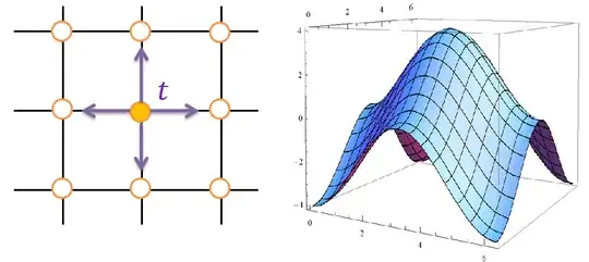

We use tight-binding approximation. We consider only 2Pz orbitals and up to the nearest hopping integral t. Of course, t is a real number. In this case, Hamiltonian matrix is one dimenstional since number of atoms in the unit cell of this system is only one and given by $$ H(k_x,k_y) = te^{ik_xa}+te^{-ik_xa}+te^{ik_ya}+te^{-ik_ya} \\ =2t \cos{k_xa}+ 2t \cos{k_y a}, $$
where a is lattice constant. And we can define wave vector $\vec{k}=(k_x,k_y)$ because system has periodic boundary condition. Right figure is energy dispersion of this system.

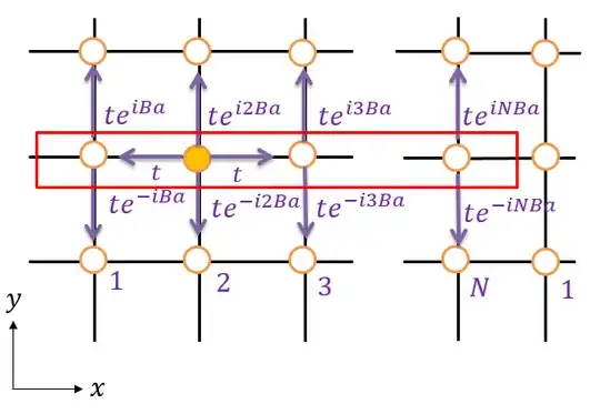

We consider the square lattice with the vertical magnetic field $\vec{B}=(0,0,B)$. We define the vector potential $\vec{A}=(0,Bx,0)$. In this system, transfer integral becomes complex number because of Peierls phase. You know that when we consider magnetic field transfer integral t become $${\rm texp}[i\int_C \vec{A} \cdot d{\vec r}].$$ C is the path of the hopping. In this system, hopping integral of x-direction does not change because $${\rm exp}[(0,Bx,0)\cdot(1,0,0)]=1.$$
But hopping integral of y-direction change and it depends on the x position. This is why the number of atoms in a unit cell becomes N. The red line means unit-cell of this system in the figure. Now, we consider periodic boundary condition in x and y-direction. So,
\begin{eqnarray} te^{i(N+1)Ba}=te^{iBa}. \end{eqnarray}
We can understand $B$ should be satisfied with
$$ B=\frac{2n \pi}{Na} $$
where n is integer.

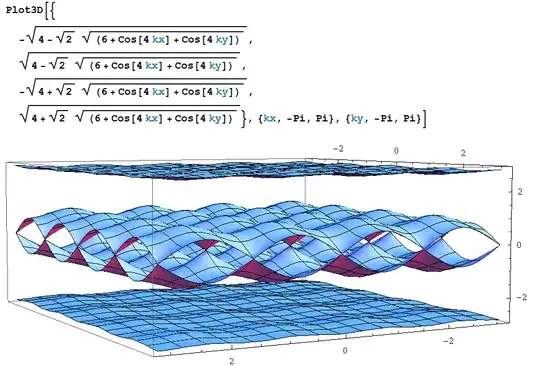

So I made the hamiltonian matrix in case of $N=4$. $$\begin{pmatrix} 2t\cos{(Ba+k_ya)} & te^{ik_xa} & 0 & te^{-ik_xa}\\ te^{-ik_xa} & 2t\cos{(2Ba+k_ya)} & te^{ik_xa} & 0\\ 0 & te^{-ik_xa} & 2t\cos{(3Ba+k_ya)} & te^{ik_xa}\\ te^{ik_xa} & 0 & te^{-ik_xa} & 2t\cos{(4Ba+k_ya)}\\ \end{pmatrix}$$
And according to the Mathematica8, we can know the Eigenvalues analytically, and I plotted it for t=1,a=1 and n=1. So this is energy dispersion of square lattice with magnetic field. Is this correct??
Edit
According to the Mathematica8, when B=0, eigenvalues of the 4-dimensional Hamiltonian are $$ -2t\cos{k_xa}+2t\cos{k_ya}, \\ 2t\cos{k_xa}+2t\cos{k_ya},\\ 2t\cos{k_xa}-2t|\sin{k_ya}|,\\ 2t\cos{k_xa}+2t|\sin{k_ya}|. $$
It is very strange. Why it is not same as the result of the previous section "Without magnetic field"
I found this document. Would you see Fig.2.6? I feel this figure is same as mine.
Even though you enlarge the unit cell in $x$ direction, you apply the magnetic periodic boundary condition in both $x$ and $y$. On the other hand, when you choose the magnetic unit cells to be $N$ times larger than the lattice ones, your Brillouin zone also shrinks $N$ times. Hence, the energy spectrum is usually depicted with respect to magnetic momenta.
Reference: W. Cai and G. Galli, "Ab Initio Calculations in a Uniform Magnetic Field Using Periodic Supercells", Phys. Rev. Lett. 92, 186402 (2004).
