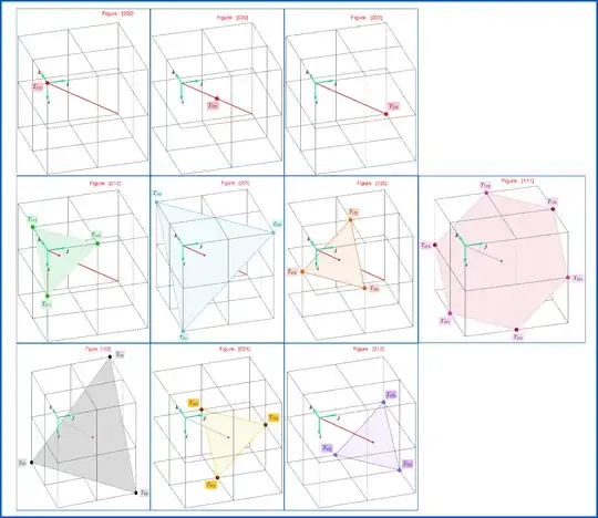

\begin{equation} x_{1}+x_{2}+x_{3}=3 \tag{B-14} \end{equation} Let arrange the 27 components of tensor $\:T_{ijk}\:$ on a cube. In this case to the 10 classes of its elements, see equation (B-13), there correspond 10 geometrical figures : \begin{equation} \begin{matrix} \left[300\right],\left[030\right],\left[003\right] & : & \textbf{3} & \textbf{points} \text{ on the main diagonal} \hphantom{===============}\\ \left[210\right],\left[201\right],\left[120\right],\left[102\right],\left[021\right],\left[012\right] & : & \textbf{6} & \textbf{equilateral triangles} \text{ normal to the main diagonal}\hphantom{==}\\ \left[111\right] & : & \textbf{1} & \textbf{regular hexagon} \text{ normal to the main diagonal}\hphantom{====} \end{matrix} \tag{B-13a} \end{equation} This representation is given in the Figure below. Each one of these 10 figures is invariant with respect to any pair of indices of its elements. So, if to the elements of each figure we attach a variable independent of the 9 variables attached to the rest 9 figures we produce a totally symmetric tensor $\:S_{ijk}$. This tensor, by the method of its production, is 10-dimensional. Such a production is given in equation (B-15). See each one of the 10 figures separately in larger size here : 10 invariant figures.
enter image description here So, we would extract from $\:T_{ijk}\:$ a 10-dimensional totally symmetric part $\:S_{ijk}\:$ as follows : \begin{equation} \begin{split} 1)\left[300\right]: & S_{111}=T_{111} \\ 2)\left[210\right]: & S_{112}=S_{121}=S_{211}=\dfrac{T_{112}+T_{121}+T_{211}}{3}\\ 3)\left[201\right]: & S_{113}=S_{131}=S_{311}=\dfrac{T_{113}+T_{131}+T_{311}}{3}\\ 4)\left[120\right]: & S_{122}=S_{212}=S_{221}=\dfrac{T_{122}+T_{212}+T_{221}}{3}\\ 5)\left[111\right]: & S_{123}=S_{231}=S_{312}=S_{321}=S_{213}=S_{132}=\\ & \dfrac{\left(T_{123}+T_{231}+T_{312}\right)+\left(T_{321}+T_{213}+T_{132}\right)}{6}\\ 6)\left[102\right]: & S_{133}=S_{313}=S_{331}=\dfrac{T_{133}+T_{313}+T_{331}}{3}\\ 7)\left[030\right]: & S_{222}=T_{222} \\ 8)\left[021\right]: & S_{223}=S_{232}=S_{322}=\dfrac{T_{223}+T_{232}+T_{322}}{3}\\ 9)\left[012\right]: & S_{332}=S_{323}=S_{233}=\dfrac{T_{332}+T_{323}+T_{233}}{3}\\ 10)\left[003\right]: & S_{333}=T_{333} \end{split} \tag{B-15} \end{equation} that is taking $^{\prime\prime}$mean value$^{\prime\prime}$ in each class.

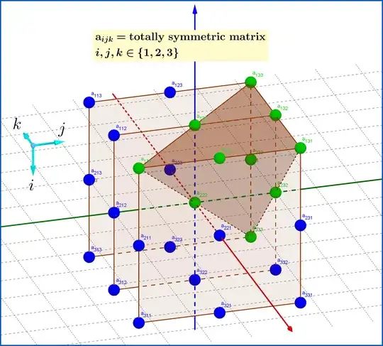

enter image description here See a 3D version of above Figure here : Totally Symmetric Matrix

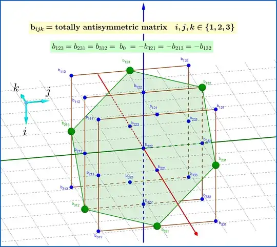

[Note C] : In the Figure below a totally antisymmetric tensor $\mathrm{b}_{ijk}$ is shown. The tensor is 1-dimensional.
See a 3D version of above Figure here : Totally Antisymmetric Matrix
