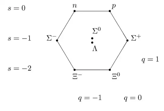

baryon octet , so there is hardly any complication.
The Λ is an isosinglet uds, so disconnected from the $\Sigma^\pm $, uus, dds, in terms of isospin raising/lowering operators $I_\pm$, unlike the $\Sigma^0$ (also uds) which is gotten from these via these operators.
These two states are also orthogonal, as all isosinglets are orthogonal to isotriplets.
$\Lambda \sim (uds - dus) \times ... \qquad \hbox{versus} \qquad \Sigma^0\sim (uds+ dus) \times ... .$
