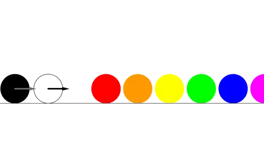

Let's start with an observation from billiards. Say the red ball is stationary and you hit it dead-on with the cue ball at speed $v$. The cue ball will stop and the red ball will continue on at speed $v$. Lubos gave a nice, simple description of this in his answer. You can see it happening at the beginning of this video.
Now imagine a row of balls (red-orange-yellow-green-blue-violet, say) lined up perfectly.
You hit the red one dead-on with the cue, and the cue stops and the red ball goes ahead. After just a moment, the red ball hits the orange ball. The red one stops and the orange on goes on ahead. Then the orange one hits the yellow one and stops, etc. Ultimately the violet ball comes out of the line, and all the other balls in the line have just moved down the table a little way. One ball in, one ball out. You can see something pretty much like this happen 50 seconds into the same video (it's not quite perfect, though).

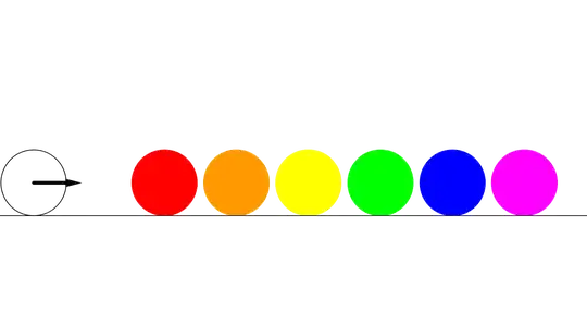

Now we do it again. Line up all the balls, but this time roll the cue ball towards the red ball, and roll the 8-ball right after it.
The cue ball strikes the red ball and stops; the red ball goes forward, as before. The red ball hits the orange ball. This time, that's not the only thing happening. Simultaneously with that collision, the 8-ball runs into the stopped cue ball. After these collisions there are two balls in motion - the orange ball in front, and the cue ball, which has now had two collisions, one in front and one from behind.
This process repeats, going down the line, always with two balls in motion with one stationary ball in between. Near the end, the two moving balls are the violet (last) ball and green (third-from-last) ball. The violet ball is free, but the green ball impacts the blue one, and that's the last collision. The result is that the blue and violet balls come away from the line up. Everything else is stopped. Two balls went in, and two come out.
From here it is not hard to see that we could send in three, four, or even 100 balls (in theory) and get the same number out again.
