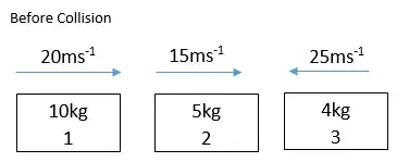

I was attempting to solve a three body problem which I made up that goes like this:
The diagram shows their velocities and masses just before collision.
The coefficient of restitution between each of the objects is 0.5.
The task is to work out their velocities after collision.I got answers, although I'm not sure if my method was correct.
I started off by calculating the total momentum, which was:
$10*20 + 5*15 + 4*(-25) = 175$ kgm/s
So obviously the total momentum after collision must be 175kgm/s.

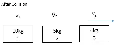

From this observation, it can only mean that object 3 will move to the right, otherwise momentum couldn't possibly be conserved. This therefore implies that object 3 will have the greatest velocity (not necessarily in magnitude, although if we consider it vectorially with positive and negative numbers), of the three objects.
So we'd have something like this:
Whatever the velocities of objects 1 and 2 are, we know that:
  • The velocity of object two will be less than the velocity of object 3
  • The velocity of object 1 will be less than the velocity of object 2
  • So $v_{3}>v_{2}>v_{1}$
We know that since momentum will be conserved: $10v_{1} + 5v_{2} + 4v_{3} = 175 $

83457
  • 199
The order in which the collisions occur is important. The outcome is different if 1&2 collide first or if 2&3 collide first. In your scenario both collisions occur simultaneously. But collisions between rigid bodies are instantaneous, so that one of the 2 collisions will happen first, if we look on a small enough time scale. Therefore I think that a simulataneous collision, in which 3 or more rigid objects are in contact simultaneously, must be ambiguous. Because of this I think your method is not valid.
The fault is the rigid-body model, which implies that collisions are instantaneous. Real bodies are deformable to some extent, and deformation takes a finite time. Unlike in the rigid body model, it is possible for a 2nd collision to start before a 1st has ended, with the result that 3 colliding bodies can be in contact simultaneously. Forces can then be transmitted between bodies 1&3 through body 2, at the speed of sound in body 2. If this transit time is less than the duration of each collision, the 2 collisions will affect each other.
A simultaneous collision between more than 2 rigid objects is indeterminate, even in 1D. There are 3 unknown speeds in the outcome, but only 2 constraining equations (conservation of momentum, the restitution law). This indeterminacy also arises when considering forces in static structures, eg Calculating distribution of force in a N-body system of balls.

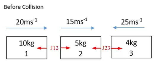

Total linear momentum is conserved, so however much momentum is added to one body due to a collision must also be removed from another body. These exchanges of momentum are called impulses.
With three bodies there are 2 impulses shown below as $J_{12}$ and $J_{23}$
fig1
To find their magnitudes we need to solve a 2×2 system.
  1. First, find the two relative velocities
    • $v_{12} = v_1 - v_2$
    • $v_{23} = v_2 - v_3$
    with the convention of positive for vectors to the right.
  2. During collisions, the relative velocity change is similarly defined by the change in velocities for each body.
    • $\Delta v_{12} = \Delta v_1 - \Delta v_2$
    • $\Delta v_{23} = \Delta v_2 - \Delta v_3$
  3. Also due to the law of contacts the change in relative velocity is proportional to the relative velocities
    • $v_{12} + \Delta v_{12} =-\epsilon v_{12}$
    • $v_{23} + \Delta v_{23} =-\epsilon v_{23}$
  4. Then we look at the change in velocity for each body due to the two impulses
    • $\Delta v_1 = - \frac{J_{12}}{m_1} $
    • $\Delta v_2 = \frac{J_{12} - J_{23}}{m_2}$
    • $\Delta v_3 = \frac{J_{23}}{m_3} $
  5. Combine all of the above to create the system of equations for the solution. First, use steps 1 and 2 in step 3 to get
    • $\Delta v_1 - \Delta v_2 =-(1+ \epsilon) (v_1 - v_2)$
    • $\Delta v_2 - \Delta v_3 =-(1+ \epsilon) (v_2 - v_3)$
    Then use step 4 above to expressed the changes in velocities in terms of the impulses
    • $- \frac{J_{12}}{m_1} - \frac{J_{12} - J_{23}}{m_2} =-(1+ \epsilon) (v_1 - v_2)$
    • $\frac{J_{12} - J_{23}}{m_2} - \frac{J_{23}}{m_3} =-(1+ \epsilon) (v_2 - v_3)$
    The above in matrix form is
    $$ \begin{vmatrix} \frac{1}{m_1} + \frac{1}{m_2} & - \frac{1}{m_2} \\ - \frac{1}{m_2} & \frac{1}{m_2} + \frac{1}{m_3} \end{vmatrix} \begin{vmatrix} J_{12} \\ J_{23} \end{vmatrix} = (1+\epsilon) \begin{vmatrix} v_1-v_2 \\ v_2-v_3 \end{vmatrix} $$
  6. Once the above is solved and the impulses $J_{12}$ and $J_{23}$ are known, then we use them in step 4 to get the changes in velocities
    $$\begin{vmatrix} \Delta v_1 \\ \Delta v_2 \\ \Delta v_3 \end{vmatrix} = \begin{vmatrix} -\frac{1}{m_1} & 0 \\ \frac{1}{m_2} & -\frac{1}{m_2} \\ 0 & \frac{1}{m_3} \end{vmatrix} \begin{vmatrix} J_{12} \\ J_{23} \end{vmatrix} $$
  7. The final velocities are found from the initial velocities and the changes in velocity
    • $v_1^\text{after} = v_1 + \Delta v_1 $
    • $v_2^\text{after} = v_2 + \Delta v_2 $
    • $v_3^\text{after} = v_3 + \Delta v_3 $

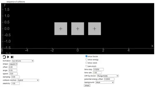

Even though the above is mathematically correct, it does not necessarily reflect reality.
Read this very informative article about how to simulate simultaneous collisions and you will find how difficult it is to get realistic results. Some of the key points are
  • The order of collisions is important.
  • Collisions are more realistic if handled sequentially even for cases where they should be simultaneous, like a Newton's cradle.
  • Impulse-based collisions, and force-based collisions each have advantages and disadvantages and neither can handle all cases without problems.
  • A hybrid approach seems to yield the best results.
scr2
URL: https://www.myphysicslab.com/engine2D/collision-methods-en.html
