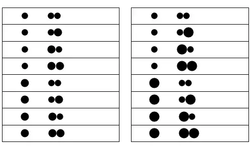

Using a "successive impact model" (as if each ball were seperated from the other ones), I produced the following animations:
You can see any combination of balls with masses of 1 or 2 (left) or 1 and 4 (right).

Experimental results can deviate from ideal. Outcomes depend sensitively on small differences in mass and alignment, and the extent to which kinetic energy is conserved. Alignment of non-identical balls is much more difficult. Considerable effort and expense may be required to achieve reliable results.
Although Simanek displays his apparatus, his webpage mostly contains animations. The only video clip (ooO <--> Ooo) does agree reasonably well with your simulation (#2 and #5). Perhaps his other videos were less convincing and left out for that reason.
Simanek's observation that the OoO collision is symmetrical might have been correct for the size of balls he used. (Judging by his video clip, I suspect that his apparatus did not actually show perfect symmetry.) In your simulation, although the 2:1 mass collision is not symmetrical, the 4:1 mass collision is much closer. Probably the n:1 collision gets more symmetrical as as n --> infinity.
Your simulation implements conservation of kinetic energy as well as momentum perfectly, so it ought to be more reliable than experimental results, which cannot guarantee perfectly elastic collisions and perfect alignment. However, investigating the differences with experiment may unearth interesting physics, particularly when the "successive impact model" does not apply.
