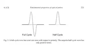

On the justifications front, a friend recently found a resource that offers some foundations for this principle, in the book chapter
from which the relevant passage runs as follows:
2.4 The "zero area" pulse
An interesting feature of a travelling electromagnetic wave is that it must have equal amounts of positive and negative field, meaning the shortest optical pulse that could be generated would be one full cycle. It is not possible to generate and transmit a unipolar electromagnetic pulse that consists of only 1/2 cycle. A plot of both cases is shown in fig. 3.
This can be easily understood from the Fourier analysis of the propagating wave. The Fourier spectrum of a propagating unipolar pulse (right-hand side of fig. 3) will have a DC term. To launch a unipolar pulse, it would be necessary to transmit a transverse DC potential with the rest of the waves. But it is impossible to establish a transverse DC potential in space, thus it is impossible to create such a pulse.
Because no propagating wave can have a DC component, pulses must have equal amounts of positive and negative field. Propagating fields will always have an oscillatory structure with at least one cycle. Another way to look at this is to recognize that all physically realizable pulses must have an average area of zero - i.e. there is just as much negative as positive field in a total optical pulse.
This is, then, a formal appearance of the principle in the literature - and in a resource that otherwise looks pretty solid, too -, but I find it deeply problematic. My problems are most easily condensed around the phrase
because there is no such thing as a 'transverse DC potential', since DC fields don't have a propagation and the notion of 'transverse' is therefore meaningless. More generally, I'm really troubled by the mixture of a Fourier decomposition (which looks at the whole experiment globally, i.e. you need to treat the entire time interval as a unified whole for the analysis to make sense) with talk of 'launching' those Fourier components.
