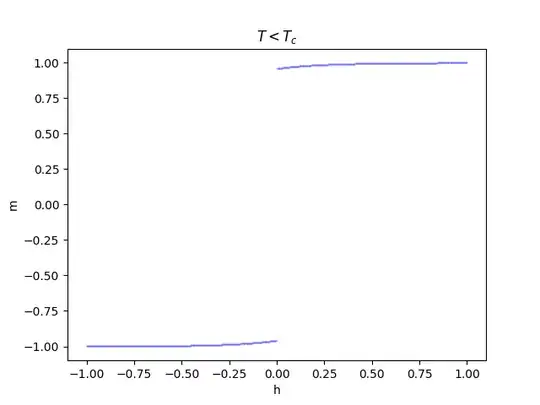

-- Second scenario: Quasi-static change
One may consider a variation of the first scenario where, at a fixed $ T < T_c $, the strength of the magnetic field is slowly (quasi-statically) varied from a positive value to some negative value. We observe that in this case, $ m $ has a jump at $ h = 0 $ (see figure below); therefore, a discontinuous (1st-order) phase transition happens when $ h $ crosses 0.
For concreteness, let's suppose that we prepare the system in a preferred magnetised state (say, $ \uparrow $) with a tiny external field $ h_\uparrow $ in a temperature $ T < T_c $, and then we slowly vary the magnitude of the field to a finite value $ h_\downarrow $ in the opposite direction. Then we calculate the free energy and entropy in the initial and final phases and changes thereof:

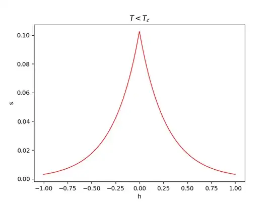

By an analogous method, we can see that entropy has also a singularity:
$$ s = - \frac{\partial f}{\partial T} \sim \text{const.} - \frac{h}{T} (m \, \frac{\partial m}{\partial h}) ~. $$
The derivative, $ \frac{\partial m}{\partial h} $ behaves like a $\delta$-function, so we can “model” it by a Lorentzian of infinitesimal width $\varepsilon$,
$$ \frac{\partial m}{\partial h} = \lim_{\varepsilon \rightarrow 0} \frac{1}{h^2 + \varepsilon^2} ~, $$
where unnecessary factors are dropped in the Lorentzian. Then, the entropy behaves as
$$ s \sim \lim_{\varepsilon \rightarrow 0} \frac{h \, \text{sign}(h)}{h^2 + \varepsilon^2} = \lim_{\varepsilon \rightarrow 0} \frac{| h |}{h^2 + \varepsilon^2} = - \frac{1}{|h|} ~. $$
So, $ s(h) $ behaves non-analytically as $ -\frac{1}{|h|} $ in the vicinity of $ h = 0 $ (in the ordered phase when $ T < T_c $) (see figure below). This completes the picture of the discontinuous phase transition.
