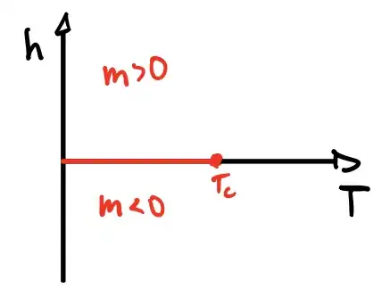

Ising model phase diagram
The first order phase transition of the Ising model is effected by a change of sign in the applied magnetic field $h$ below the critical temperature $T_c$. This results in a discontinuous change in the magnetisation $m$. The latent heat $L$ associated with the transition depends on difference in entropy $\Delta s = s_+ - s_-$ between the up and down phases, and the temperature $T$ of the transition: $$ L = T \Delta s \, .$$ However, as the up and down phases are completely symmetric, they have the same entropy and therefore $$\Delta s = L = 0 \,.$$
This can also be seen from the Clausius-Clapeyron relation, $$\frac{dh}{dT} = \frac{L}{T \Delta m} \, . $$
From the phase diagram, it is obvious that $\frac{dh}{dT} = 0$, leading to $L = 0$.

Latent heat is associated with a transition in which there is a change in temperature, keeping the other fields constant. Furthermore, the transition is from an ordered configuration to a disorder. Examples with lattice models are the q=10 Potts model, Baxter-Wu 3D and others. In the Ising model, the first-order phase transition occurs with the variation of the external field, keeping the temperature constant. In this case the transition occurs between two ordered phases. In the first-order transition with temperature, the energy probability distribution has a double peak, the energy difference of the distribution maxima is the latent heat. In the transition with an external field, the probability distribution of the order parameter has a double peak. In both we find discontinuities in the thermodynamic quantities. An article where you can find more details of first-order transitions is Phys. Rev. B 26, 2507 (1982) - Scaling for first-order phase transitions in thermodynamic and finite systems.
