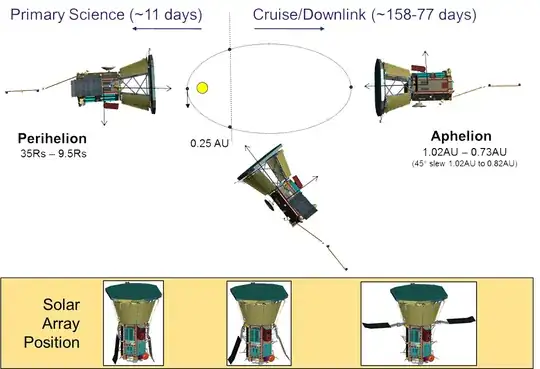

above: Parker Solar Probe cropped, from here.

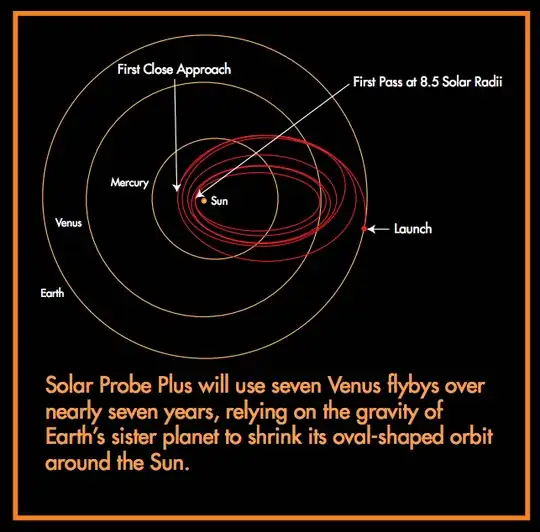

above: Illustration of the Parker Solar Probe's orbit, from here.

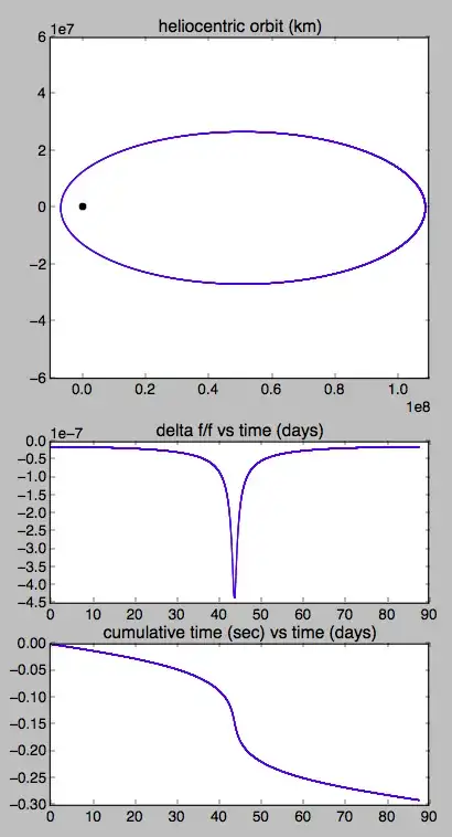

To calculate the approximate total shift in elapsed time you would have to integrate over the orbit. With a period of about 3 months (87.7 days) I get a total shift of about 0.3 seconds per orbit:
Python script: https://pastebin.com/EyJbfQVZ
