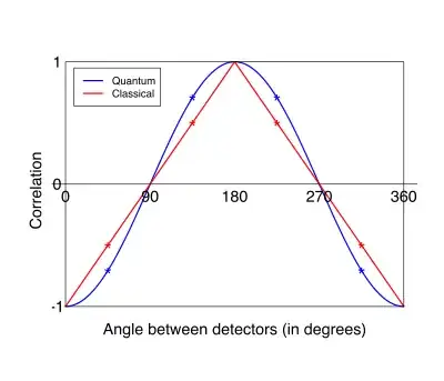

Actually both quantum and classical correlations are zero when the measurements of Alice and Bob detectors involve z and x components, respectively. The above is clearly shown in the beginning of the naive view of an experimentalist and in the image below.
More surprising results arise at smaller angles. I've found the easiest explanation to understand from wikipedia:
Start with one setting exactly opposite to the other. All the pairs of particles give the same outcome (each pair is either both spin up or both spin down). Now shift Alice's setting by one degree relative to Bob's. They are now one degree off being exactly opposite to one another. A small fraction of the pairs, say f, now give different outcomes. If instead we had left Alice's setting unchanged but shifted Bob's by one degree (in the opposite direction), then again a fraction f of the pairs of particles turns out to give different outcomes. Finally consider what happens when both shifts are implemented at the same time: the two settings are now exactly two degrees away from being opposite to one another. By the mismatch argument, the chance of a mismatch at two degrees can't be more than twice the chance of a mismatch at one degree: it cannot be more than 2f.

Anyway, the measurements only along axis can't be used to rule out a possible classical explanation (local realism) - in other words initial conditions (hidden variables distributions) exist such that measurements along same axis are anticorrelated, while along different ones have zero correlation - so, once more, Bell inequality is meaningful at smaller angles (as already discussed in the first part of this answer) between Alice's and Bob's detectors.
