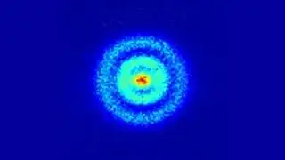

Lets make it simpler : here are measurements of the electrons in the orbitals of the hydrogen atom:
measured hydrogen orbital
Each dot there is an (x,y) measurement from a single hydrogen atom. Orbitals are the probability loci for the electrons about the proton of the hydrogen.When that electron interacted with the detecting system, it was there.
Quantum mechanics is the theory that models and predicts what the accumulation of all the measurements will show ( the probability distribution)
