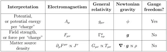

Electromagnetism and general relativity can both be thought of as gauge theories, in which case there is a natural analogy between them:
(Strictly speaking, the gauge symmetry of diffeomorphism invariance of the metric $g_{\mu \nu}$ reduces to the global symmetry $\phi(x) \to \phi(x) + \text{const.}$ in the Newtonian limit.)
The theories can also both be thought of as connections on fiber bundles, in which case there is a different natural analogy between them:
Here (deep breath) $A_\mu = A$ is the electromagnetic vector potential, $g_{\mu \nu}$ is the metric, $\phi$ is the Newtonian gravitational potential field, $F_{\mu \nu} = F$ is the electromagnetic field strength tensor, $\Gamma^\mu_{\nu \rho}$ is the Christoffel connection, ${\bf g}$ is the Newtonian gravitational field, $J^\mu$ is the electric four-current, $G_{\mu \nu}$ is the Einstein tensor, $T_{\mu \nu}$ is the stress-energy tensor, $\rho$ is the spatial mass density, $L$ stands for "length", and $R_{\mu \nu \rho \sigma}$ is the Riemann curvature tensor (whew!).
Unfortunately, as noted in Dimensional analysis of metric tensor, these two analogies don't match up! The electromagnetic four-potential $A_\mu$ and field-strength tensor $F_{\mu \nu}$ correspond to the metric $g_{\mu\nu}$ and Christoffel connection $\Gamma^\mu_{\nu \rho}$ respectively in the first analogy, and to the Christoffel connection and Riemann curvature tensor $R_{\mu \nu \rho \sigma}$ respectively in the second. This doesn't seem right - surely there should be a single unified formulation of each theory in which the gauge-theory and fiber-bundle stories are naturally compatible. So what the heck is going on?

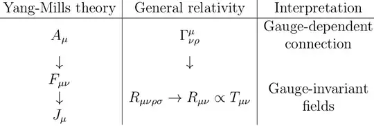

It seems that, contrary to my first impression, both of the analogies above really are just analogies, and neither correspondence is particularly tight. Yang-Mills theory and GR really are qualitatively different kinds of ``gauge theories'', because in Yang-Mills theory the gauge-invariant field strength tensor $F_{\mu \nu}$ is formed from first derivatives of the fundamental fields, while in GR the gauge-invariant field strength tensor $R_{\mu \nu \rho \sigma}$ is formed from second derivatives of the fundamental fields. So both analogies above are useful in different contexts, but far from perfect.
However, we can make the second analogy tighter by considering the Palatini formalism of GR, where we treat the metric and the connection as independent fields and vary the action with respect to each separately. Under this formalism, the fiber bundle connection itself is a fundamental field, just as in Yang-Mills theory. (But there is still a major difference between the theories, which is that sections of the fiber bundle appear explicitly in GR as $g_{\mu \nu}$ but not in classical electromagnetism.)
Edit: The general consensus seems to be that this is the "best" analogy, where downward-pointing arrows denote derivatives and rightward-pointing arrows denote tensor contractions:
The strange thing about this analogy is that the equations relating the "field strength tensor" to the "matter source field" are very different in the two cases: the Yang-Mills equation of motion $d(*F) = J$ is a dynamical differential equation, while the analogous general relativity equation of motion $R^\rho_{\ \, \mu \rho \nu} - \frac{1}{2} g^{\sigma \lambda} R^\rho_{\ \, \sigma \rho \lambda} g_{\mu \nu} \propto T_{\mu \nu}$ is just an algebraic relation with no derivatives. I'm not sure what to make of that.
