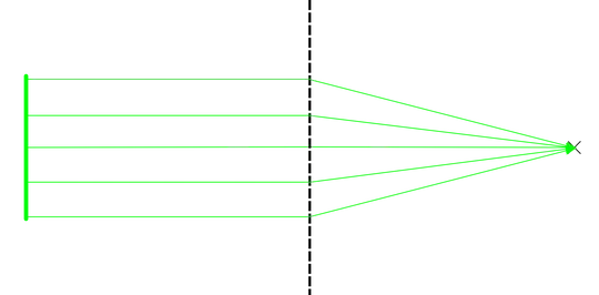

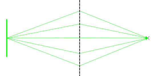

From the symmetry properties of Maxwell's equations optical paths must be bidirectional – exchanging start and end point results in the same path, just reversing its direction. That means that there is no optical element transforming two distinct paths onto one path. In a normal optical transformation like in the first picture you can map a set of rays that are distinguishable by their direction of propagation onto another set of rays distinguishable by their direction of propagation:Mapping light rays emitted from one point in an extended source onto one point.
Likewise you can map rays with the same direction of propagation but different positions onto a set of light rays that intersect, but can be distinguished by their direction of propagation:Mapping light rays emitted into the same direction onto one point.

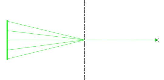

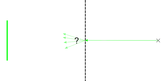

But imagine a set of light rays coming from different spots in the extended source hitting the lens at exactly the same position. In order to make all the light from these rays go through the desired point the lens must map them onto exactly the same outgoing beam:Mapping light rays entering the lens at the same point but at different angles onto the same ray – impossible! This kind of mapping is not reversible:Where should the beam go?

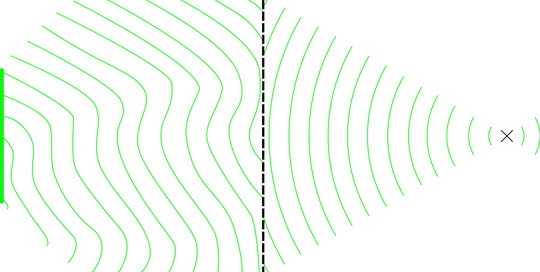

The von Neumann equation leaves a possible setting where all light from an extended source can still be focussed onto one point (or let's say diffraction limited spot). In the case of a pure state $\hat{\rho}_{\text{pure}} = \left| \Psi \right\rangle \left\langle \Psi \right|$ with minimal entropy there is no decrease of entropy necessary to focus it onto one spot. This can be achieved with a spatially coherent source, e. g. a source where the shape of the wavefronts does not change over time. Then, knowing the wavefronts in the plane of the lens one just needs to produce a phase mask that accumulates optical phase in each point such that a spherical wave is created:A spatially coherent source has a very low entropy, hence it can be focussed to a diffraction limited spot. However, usual extended light sources are not spatially coherent. And making an incoherent source spatially coherent would again violate thermodynamics...
