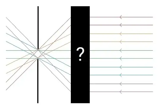

I'm searching for an optical element that converts a parallel bundle of individually collimated beamlets into a converging or diverging bundle of still collimated beamlets (or vice versa). So basically the blackbox in the following ray diagram, but with beamlets (red, green, blue) going from right to left:
Ray diagram 1
(Image: Modified from original)
The diagram is actually a good representation of the problem as, after passing through the optical element in question, the beamlets are supposed to be focused by a telecentric lens system (here: "Lens, f = 100 mm"), with the aperture stop representing the rear entrance pupil of the telecentric system.
  • The big challenge here is that the angle of the individual beamlets passing through an aperture stop needs to stay variable or, in other words, the spacing of the parallel input bundle. Therefore, e.g. a lens/fiber array or segmented prism would not work as the distance between the individual beams isn't fixed.
  • Also, a potentially large number of beamlets would quickly drive up material costs and alignment complexity. Consider e.g. a confocal array of 100 fibers, requiring 100 output collimators, 100 fiber launchers for 1000-1500 EUR apiece (or some crazy 1-to-100-port fiber multiplexer), and 200 individual alignments. Clearly, a monolithic solution would be extremely beneficial!
Obviously, a simple/economic solution is desired, as one surely can - somehow - design a super-complex system with dozens of elements that does the job. This also precludes any fancy control loops with adaptive optics, wavefront sensors etc. In other words, the system should be scalable and lend itself e.g. to miniaturization.
I've been thinking about this for a while now and was hoping that maybe there is something blatantly obvious that I'm missing...

I should also mention that, differing from the diagram, the individual beamlets do not actually overlap, which could potentially simplify the problem. Imagine a bundle of expanded and collimated laser beams that all need to pass through a small aperture while retaining collimation (or at least have identical wavefront curvatures, so all beamlets are focused into the same focal plane by the telecentric system). For clarity, here is a second sketch showing only the optical element in question (please ignore the non-uniform output beam diameters):
