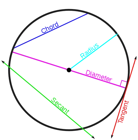

In integrals such as that in the Biot-Savart law, $$\mathbf B = \int_C \frac{I \, d \mathbf l \times \mathbf r'}{|\mathbf r '|^3}, $$ the integral is over a curve $C$, and $d\mathbf l $ represents an infinitesimal displacement along the curve. More rigorously, it is tangent to the curve, the red line in the figure below, which is the limit of the green line, a secant, as the two points of intersection approach each other. As you can see, it has a direction, so it must be a vector quantity.
Figure from Wikipedia page on Tangent
