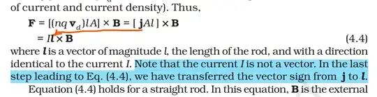

I am reading chapter "Moving Charges and Magnetism" in NCERT book. In the part talking about the force on a current-carrying wire in a uniform magnetic field, I read this strange transformation of vectors. I have highlighted the relevant parts.
Can someone explain how and why did that happen?

$nq$ is the density of moving charges $\rho$. So, $$\mathbf j = \rho \frac{\mathbf{dx}}{dt}$$ If the density of current is constant over a straight wire: $$\mathbf j = \rho \frac{\mathbf{\Delta x}}{\Delta t}$$
Naming I as $$I = \frac{\Delta Q}{\Delta t} = \frac{\rho lA}{\Delta t}$$
and $\mathbf l = \mathbf{\Delta x}$, we get the final expression.
The (j) is a unit vector indicating a direction (in an xyz coordinate system). The (l) is a length which has a magnitude. Assuming (l) is in the direction of (j), when you put them together you get a vector with a magnitude and direction.
