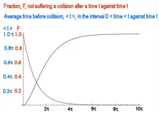

This is illustrated in the graphs below.
So only about $13\%$ of the electrons travel for a time longer than $2 \tau$ and yet they have a large effect on the average time between collisions.
After doing the sums it is found that the average speed of the electrons which is called the drift speed is indeed $\dfrac {eE\tau}{m}$

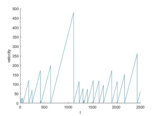

I make a simulation with $\tau = 100$, $acceleration = 1$. The behavior of a single electron looks like: single electron
The larger the velocity, the longer that free travel lasts in the time line.
By calculating the average velocity with $\frac{1}{2}a\tau$, you simply assume that each free travel accounts equally in duration, which is incorrect.
To get the real average velocity, you should calculate each area of the triangle above and average them over time: $$\frac{1}{n\tau}\sum_{i=1}^{n}\frac{1}{2}at_{i}^{2}$$
or use integration: $$\int_{0}^{+\infty}\frac{1}{\tau}e^{-t/\tau}\cdot \frac{1}{\tau}\frac{at^2}{2}dt = a\tau$$ where $\frac{1}{\tau}e^{-t/\tau}$ is the probability of an electron collides at $t$, with mean free time $\tau$.
So the correct average velocity is $a\tau=100$.

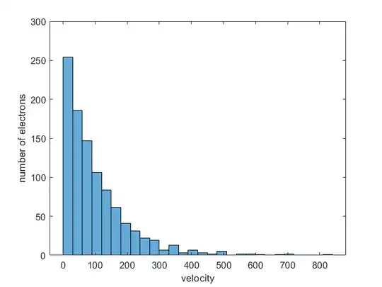

By the way, the simulation of 1000 electrons show that the velocities distribution at any time is also in accord with $\frac{1}{\tau}e^{-t/\tau}$. 1000 electrons
