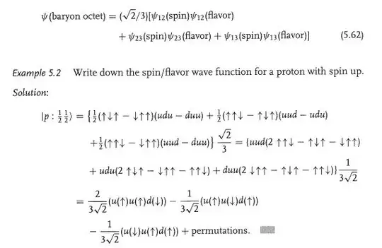

I am currently working through Griffiths' Introductory to Elementary Particle Physics and I'm a little confused about a particle's spin/flavor wavefunctions. As a specific example, I've attached Griffths solution to the proton's wavefunction, and the formula he used to get it.
I understand the solution, but what confuses me is the ordering for the antisymmetric spins/flavors. As an example, looking at the first term, wouldn't the flavors still be antisymmetric in particles 1 and 2 if we just switched the udu and duu terms. We would get a different final solution for the wavefunction now due to terms cancelling out after expanding.

Your text, with which I am not familiar, may have done some of its readers a disservice by pulling its punches at the bottom line of your formula, trying to save space. Writing down the permutation terms nets you the full proton wavefunction: $$ \frac{1}{\sqrt{18}} ~ (2 u\uparrow ~ u\uparrow ~ d\downarrow - u\uparrow ~ u\downarrow ~ d\uparrow -u\downarrow ~ u\uparrow ~ d\uparrow \\ +2 u\uparrow ~ d\downarrow ~ u\uparrow - u\downarrow ~ d\uparrow ~ u\uparrow-u\uparrow ~ d\uparrow ~ u\downarrow \\ + 2d\downarrow ~u\uparrow ~ u\uparrow - d\uparrow ~u\downarrow ~ u\uparrow - d\uparrow ~u\uparrow ~ u\downarrow ). $$ You may verify directly, by inspection!, that this is fully symmetric under interchange of the 1-2 quarks, and also the 2-3 quarks, and also the 3-1 quarks. Since the positions, 1,2,3, are placeholders for color indices, which are antisymmetrized ("off the stage"), all quarks, like bona-fide fermions are fully antisymmetrized among themselves. Confirm this is a unique composition configuration for the spin up proton state.

Specifically, when you look at the 1-2 particle interchanges in (5.62), $\psi_{12}$(spin) is antisymmetric (a spin singlet composed with a spin doublet for the 3rd quark); but it is multiplied by a flavor antisymmetric $\psi_{12}$(isopin) to yield an interchange symmetric piece.
Behold: under this same interchange, the other two pieces, in very different reps of spin and isospin rotate into each other, to net you symmetry, as you saw above, namely $$\psi_{23}(s)\psi_{23}(f) + \psi_{13}(s)\psi_{13}(f) \leftrightarrow \psi_{13}(s)\psi_{13}(f) +\psi_{23}(s)\psi_{23}(f) . $$ Their suitable pieces fit into spin triplets and isotriplets! (Embedded in flavor SU(3) this would involve the mixed symmetry octet 8 of baryons: that's why it has this funny Γ-shaped Young tableau, in case you are familiar with the symmetry accounting these provide.)

Note that Griffiths is very careful to match each of these terms, $$udu ~~\Leftrightarrow~ \uparrow \downarrow \uparrow,$$and if you match both terms at once you get two sign flips: $$(\downarrow \uparrow \uparrow - \uparrow \downarrow \uparrow)\otimes (duu - udu) = (-1)^2 (\uparrow \downarrow \uparrow - \downarrow \uparrow \uparrow)\otimes(udu - duu) $$and since $(-1)^2 = 1$ this is a non-issue.
So the real question you're asking is, why do we have to match these terms? And that's a good question and it has to do with how the 3 terms all play together (a sign flip on any individual term does nothing for consistency or inconsistency).
So the expression takes the form of "we're going to insert some $u_\uparrow$ state into the twice-antisymmetrized 2-quark state $$d_\downarrow u_\uparrow - d_\uparrow u_\downarrow - u_\downarrow d_\uparrow + u_\uparrow d_\downarrow,$$because we know we have two $\uparrow$ spins and two $u$ quarks and so one of these up-quarks has to be in the spin-up state." (Note that under $1^\text{st}\leftrightarrow2^\text{nd}$ interchange the above is in fact symmetric, that last term being exactly the first term with the two particles switching places.) Now the expression chooses to symmetrically insert this $u_\uparrow$ quark in the first position, the second position, and the third position, so that the result will still be symmetric here and will become antisymmetric after correcting for color charge.
What you're proposing by flipping the sign of the first term, therefore, is not symmetrically inserting this $u_\uparrow$ quark in each of the three spots, but inserting it in the first place with a 180-degree phase shift. And that naturally will not be properly symmetric here or antisymmetric afterwards.
