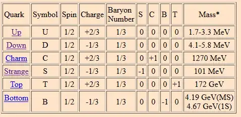

If you look at the quark table ,
quarks
you see that quarks have a specific charge, and specific other quantum numbers that have to be conserved in order for a reaction to happen, or a bound state to be allowed.
As all macroscopic matter is neutral, and the charge of proton is positive and neutron neutral, there are only unique combinations that can make up the macroscopic world, and that is what the theory that developed the quarks makes sure of. There are no contradictions, no stable baryons other than the proton and neutron, by construction in order to fit the observable world.
