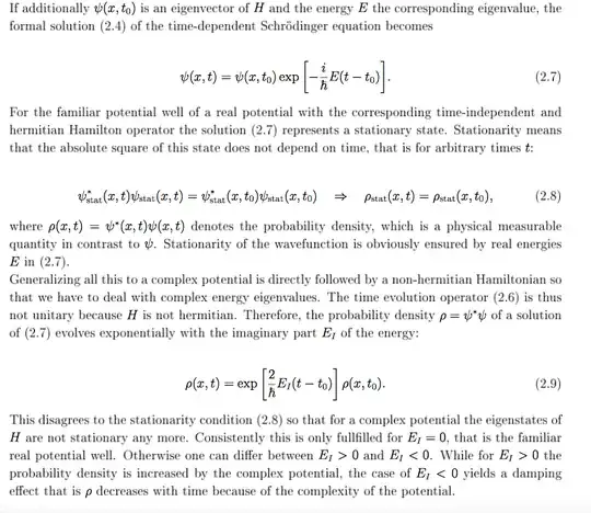

The answer in short is that when you are dealing with a complex potential, the direct consequence is that you are dealing with complex energy eigenvalues & hence a non-hermitian Hamiltonian.Therefore, for a complex potential, the eigenstates of H are not stationary anymore and that itself negates the initial assumption in the question.

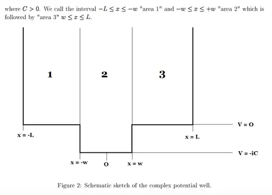

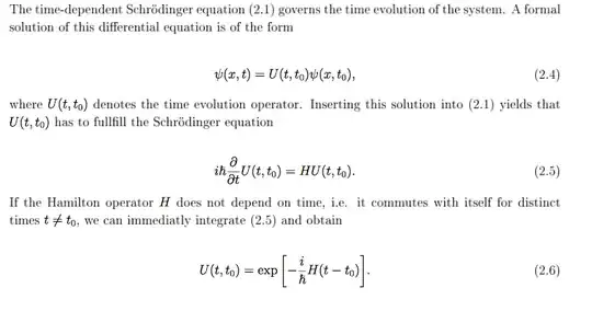

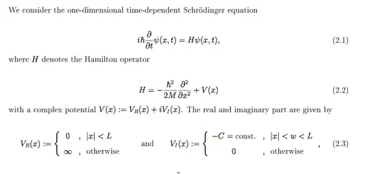

To expand on this, let me reproduce the calculations from "Complex potential well" -- Max Lewandowski, Universität Postdam, 2011 [ http://users.physik.fu-berlin.de/~pelster/Projects/lewandowski.pdf ]
enter image description here enter image description here enter image description here enter image description here
