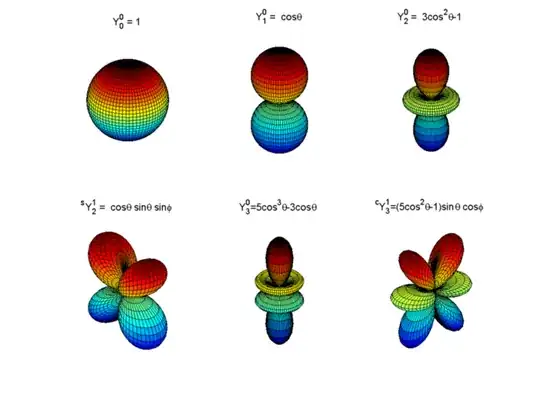

Another example are the spherical harmonics functions, which are a complete set of orthogonal functions. They can be considered as a mathematical representation of the physical fact that the set of electron orbitals around, say a hydrogen atom, will always retain their distinctive arrangement.
