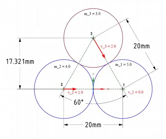

Imagine three spheres impacting at the same time:
pic
Use this MATLAB script to find their final velocties:
%% Example triple impact (with 3D vectors)
% Three spheres impact at the same time. See Figure for their
% masses, positions and velocities before impact
% define unit vectors
o_ = [0;0;0];
i_ = [1;0;0];
j_ = [0;1;0];
k_ = [0;0;1];
R = 20;
r_1 = R*i_
r_2 = -R*i_
r_3 = R*tand(60)*j_
% Three possible contacts: 1*2, 2*3, 1*3
n_12 = (r_2-r_1)/norm(r_2-r_1)
n_23 = (r_3-r_2)/norm(r_3-r_2)
n_13 = (r_3-r_1)/norm(r_3-r_1)
% velocity vectors before impact
v_1 = o_;
v_2 = -1.0*n_12
v_3 = -2.0*n_13
v = [v_1;v_2;v_3]
% mass matrix
M = blkdiag(5.0*eye(3),4.0*eye(3),3.0*eye(3))
% contact pair matrix
Z = [-n_12, o_, -n_13; n_12, -n_23, o_; o_, n_23, n_13]
% Z =
%     1.0000         0    0.5000
%          0         0   -0.8660
%          0         0         0
%    -1.0000   -0.5000         0
%          0   -0.8660         0
%          0         0         0
%          0    0.5000   -0.5000
%          0    0.8660    0.8660
%          0         0         0
% coefficient of restitution
eps = 0.5
% impact speeds
u_imp = Z.'*v
% impulses
J = -(1+eps)*inv(Z.'*inv(M)*Z)*u_imp
% J =
%     1.7021
%     2.1702
%     4.6277
% velocity vector change
Dv = inv(M)*Z*J
% final velocity
v_final = v+Dv
% v_final =
%     0.8032
%    -0.8015
%          0
%     0.3032
%    -0.4699
%          0
%     0.5904
%     0.2303
%          0
% check for error
actual = Z.'*(v+Dv);        %(relative speeds after impact) =
expected = -eps * u_imp;    % -eps*(relative speeds before impact)
err = actual-expected
% err =
%   1.0e-015 *
%    -0.1110
%    -0.6661
%    -0.6661
In the last part, I check the results against the law of contacts and the error is ~1e-15.
