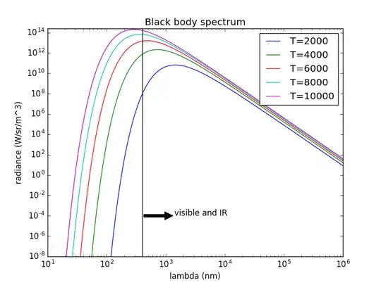

I made a little Python program that plots Planck's Law for a number of different temperatures; by using a log scale, you can see that there is "some" energy at all wavelengths, but the curves drop off steeply:

As you can see, at sufficiently high temperatures (hotter than the surface of the sun) the peak of the radiation will be in the UV (that is, below 400 nm).

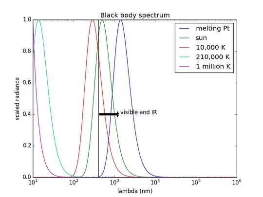

Finally here is a linear plot of the curves (scaled to their respective maximum value) for some more extreme temperatures - 2041 K (melting platinum), 5777 K (sun), 10,000 K (a very hot sun), 210,000 K and 1,000,000 K (values suggested by Keith McLary)
As before - the shapes of the curves is unchanged, but the peak moves left (and the total power goes up as $T^4$.)

* It's obvious to see why this is so: the only place in the equation where $T$ appears, it appears as $\lambda T$ so if you increase T the entire shape of the curve will shift; and the peak will be at the same value of $\lambda T$. It follows that $\lambda \propto \frac{1}{T}$
