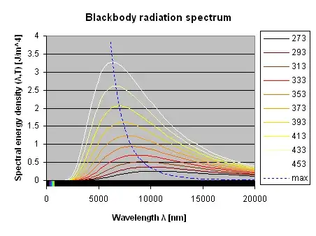

Below are plots of the black body spectrum for two different temperature regions. The top plot is for temperature around 0 degrees C to 200 degrees C

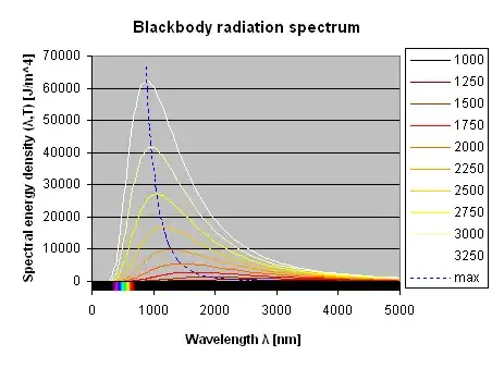

This is for temperatures around 800 degrees C to about 3000 degrees C
Notice the large scale change of the x-axis. The wavelength of the visible spectrum is indicated on the far left x-axis in both plots. You can see from this how the peak shifts for varying temperature. Very little visible light is emitted until temperature approaches about 2,500 K. The numbers in the boxes on right are temperatures in Kelvins. 273 K is freezing temperature of water. 373 K is boiling temperature of water. Close to very hot coffee.
