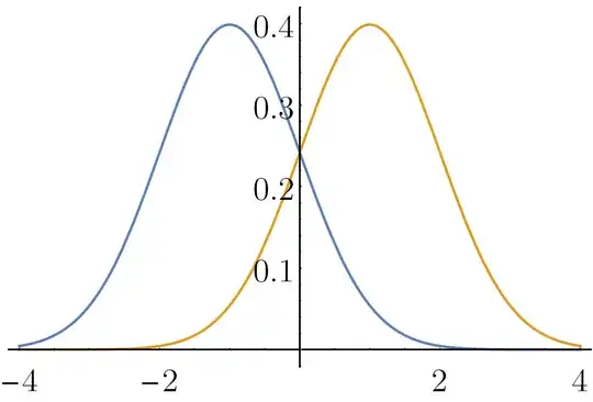

To see this more clearly, consider the simple 1-dimensional case, with two fermionic particles with partially overlapping wavefunctions. Let's call the wavefunctions of the first and second particles $\psi_A(x)$ and $\psi_B(x)$, respectively, and let us assume that their probability distributions have the form:

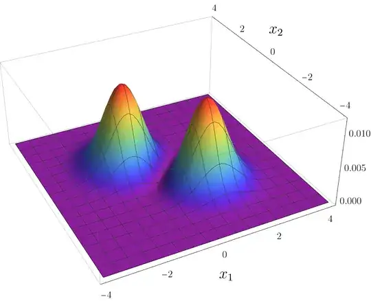

The properly antisymmetrized wavefunction of the two fermions will be given by: $$ \Psi(x_1,x_2) = \frac{1}{\sqrt2}\left[ \psi_A(x_1) \psi_B(x_2)- \psi_A(x_2) \psi_B(x_1) \right]. $$ For any pair of values $x_1$ and $x_2$, $\lvert\Psi(x_1,x_2)\rvert^2$ gives the probability of finding one particle in the position $x_1$ and the other particle in the position $x_2$. Plotting $\lvert\Psi(x_1,x_2)\rvert^2$ we get the following:
As you can clearly see from the picture, for $x_1=x_2$ the probability vanishes. This is an immediate consequence of Pauli's exclusion principle: you cannot find the two identical fermions in the same position state. But you also see that, the more $x_1$ is close to $x_2$, the smaller is the probability, as it must be due to continuity of the wavefunction.
