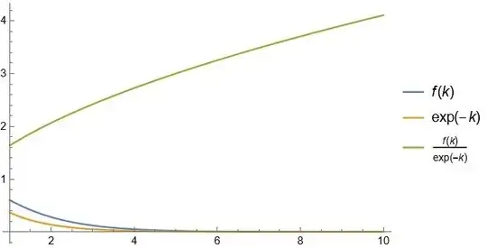

$$ \int_{-\infty}^{\infty} dt G_{\text{ret}}^{(4D)}(t, \mathbf{x}) = \phi(\mathbf{x}).$$
However, checking this with Mathematica, I observe that they do not match ($f$ is the integral of Green's function multiplied by $4\pi|\mathbf{x}|$, $g=\operatorname{exp}(-m|\mathbf{x}|), k=m|\mathbf{x}|$):
What am I supposed to do to correctly deduce the Yukawa potential, from the 4D Klein-Gordon theory?
