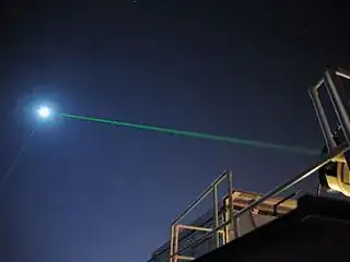

The images below are copied from the linked question for reference - example of the use of the Apollo-era retroreflectors on the Moon.
Above: Lunar libration image from here
Above: Lunar Laser Ranging (LRR) images from here

This review by Tom Murphy has a nice section on "science from lunar laser ranging." He reiterates the fundamental problem that relativistic quantum mechanics and relativistic gravitation are incompatible, and that a solution to that problem might be expected to explain the accelerating expansion of the universe. However the results he attributes to lunar laser ranging --- equivalence principle tests at the AU length scale, tests for nonzero rate of change for $G$, measurements of gravitomagnetism and precession, inverse-square-law tests, measurements which reveal properties of the lunar interior, and measurements which reveal fine details of Earth's motion --- are decidedly non-quantum-mechanical.
The APOLLO folks beat the Gravity Probe B folks to the first definitive observation of gravitomagnetism, which is an important discovery.
The efficiency of the APOLLO laser-ranging system is about $10^{-18}$: that is, sending a laser pulse to the moon with $10^{18}$ photons means you typically get about one photon back. It's pretty tough to prepare any sort of a state quantum state when you have to decrease your signal intensity by a factor of a billion squared.
I'm not aware of any quantum-mechanical discoveries that have come from the lunar laser ranging program, and I don't expect any. I think inclusion of "quantum mechanics" in your pullquote is probably just sloppiness on the part of the reporter, his interviewee, or both. (If you're willing to do surgery on the pullquote, retroreflectors are important in terrestrial optics laboratories too, where they have certainly contributed to studies of quantum information; I don't think that was the intended meaning, nor do I think it's a fair interpretation.)
