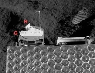

The retroreflector array is a large number of discrete reflectors, and while the astronauts took pains to align the array normal to the average direction towards Earth it's not perfect. Reflection across one reflector can be fairly coherent, but between each one and the others there will be delays of millimeters or even centimeters.

From https://space.stackexchange.com/q/14943/12102 (click for larger)
You can read more about the actual retroreflector arrays on the moon and the precision ranging measurements in
