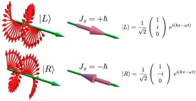

A photon only has this energy definition and a spin 1 h orientation either in its direction of motion or against it, where h is Planck's constant. The beam built up in the image, is built up by the individual photons ( middle image).
embeam and photon
This happens because the quantum mechanical wavefunction of a photon has the E and B information in its complex form, ( a solution of a quantized maxwell equation) and the superposition of photons builds up the classical fields with the frequency nu.
