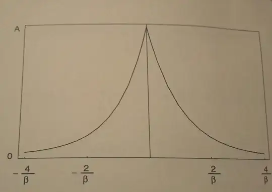

Even with a delta function potential, continuity of the wave function is still required. (Please see comment from ACuriousMind below on this).
The derivative of the wavefunction is obviously not continuous, however. You can find the discontinuity by integration about the delta function from +s to -s, where s is a small parameter.
You then let s go to 0 and check the behaviour of the derivative. You don't state the wavefunction(s) you are using, but here is a plot of a typical one.
You can find the actual calculations here:
