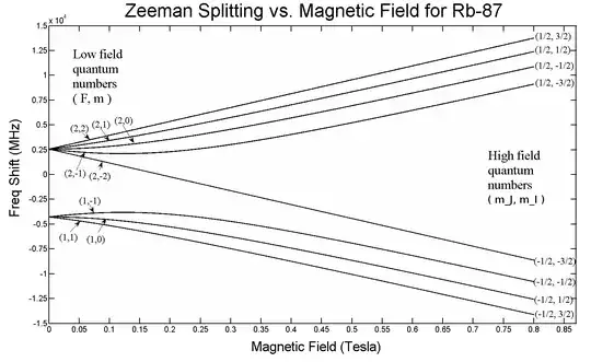

Generically, the answer is "no". The Zeeman effect is the splitting of degenerate spectral lines in the presence of a static magnetic field. As the field strength increases, some lines move to higher energies and some lines move to lower energies. Example of the splitting of the $5s$ orbitals of Rubidium:
Graph showing the Zeeman splitting in Rb-87, the energy levels of the 5s orbitals, including fine structure and hyperfine structure. (Graph created by: Danski14. Image used under Creative Commons Attribution-Share Alike 3.0 Unported license)
Note that the levels don't even move monotonically: The (2,-1) and (1,-1) levels move towards zero frequency shift for small field and then away for large fields.
Similarly, the Stark effect (shifting and splitting of spectral lines by an imposed electrical field) can shift to higher and lower energies. (Structurally similar shifts can be seen on the linked page as those shown above for the Zeeman effect.)

At least one commenter seems confused about what these words mean. The Zeeman splitting occurs under a uniform field. A uniform field has no potential, so makes no contribution to $\tilde{V}(x)$. In detail, using the OP's potential, $$ V(x) + \text{[uniform magnetic field]} = V(x) + 0 = \tilde{V}(x) \text{.} $$ Consequently, Zeeman splitting occurs without changing the potential at all. (This is admitted by the OP's use of $V(x) \leq \tilde{V}(x)$.)
A magnetic field is a vector field, so does not have spin dependence. That is, the uniform magnetic field is not written as a function of position and spin; it is only a function of position. The Hamiltonian contains all of the interaction terms. If there is coupling between electrons and the magnetic field, this coupling appears in the Hamiltonian. And in a Hamiltonian that has such a term, the spin of an electron does contribute to the sign of the effect of the electron-magnetic interaction. The OP gives no details about his/her Hamiltonian. If a commenter has questions about spin-dependence in the OP's Hamiltonian, the only profitable choice is to inquire with the OP.
It is perhaps unfamiliar to imagine a uniform electric field (rather than an electric field of uniform gradient). Such a field is approximately produced in doped semiconductors. Far from a p-n junction, the Stark effect deforms the orbital/band structure of the materials, differently depending on the dopant. Since we are far from the junction, the net electric field is induced by the dopant (and depletion physics) and is as uniform as your model allows. Near the junction, the local field value is intermediate and the Stark deformation of the energy levels/bands is intermediate (and a bit nonlinear since now the gradient of the electric field is not necessarily small).
So, without changing the numerical value of $V(x)$ at all, binding energies can can be shifted positively or negatively. This is observed in real atoms.
