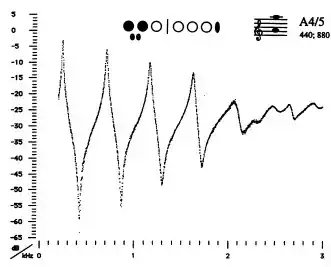

The resonances of an air column can be characterized by the pipe's impedance as a function of frequency. Below is an example of a graph, from a group an UNSW (web page).
impedance as a function of frequency for a flute
To explain this theoretically, without approximations, you have to solve the wave equation. The solutions have air that vibrates beyond the end of the tube. Ultimately this is the only "why" answer there is.
However, the fact that it can be characterized as an impedance suggests a sort of heuristic explanation by appealing to analogy with the case of zero frequency, i.e., steady flow of air through the tube, which is possible in the case of a tube that's open at both ends. In this situation, the continuity equation (i.e., conservation of air) says that as air enters (exits) the end of the tube, it has to speed up (slow down). This happens gradually because the air is spreading out from an opening of finite size.
The electrical analogy would be two very large blocks of ohmic material with connected by a solid cylinder of ohmic material. The current gets concentrated and then dispersed as it comes into and out of the cylinder.
to enlarge only slightly upon Ben Crowell's thorough and useful treatment of this topic: the simple reason that there are nonzero pressure zones immediately outside the open end of the pipe is that the pipe is radiating sound energy out the open end- in fact, the pressure right at the opening is typically nonzero itself, inasmuch as the resonant column of air protrudes slightly out the open end.
The impedance of the pipe with an open end is discontinuous at the open end and thereby presents a serious mismatch condition there, with part of the wave being reflected off the discontinuity to return back down the pipe (which contributes to the production of the standing wave inside) and part of it radiating out into the free space outside. As pointed out by Ben, the concept of impedances is very useful in this context.
