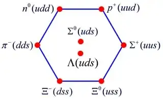

Baryon octet
There exists six ladder operators which take u,d,s quarks to (d,s),(u,s),(u,d) and back to those quark states. $$I_-u=d,\qquad I_+d=u$$ $$V_-u=s,\qquad V_+s=u$$ $$U_-d=s,\qquad U_+s=d$$ The above figure shows the quark content of those 8 quarks. Now, anti- symmetric proton state in 1,2 indices is: $$ p_A = (ud-du)u/\sqrt2 $$ By using ladder operator $U$ it gives $$ U_- p_A= \Sigma^+ = (us-su)u/\sqrt2 $$ Using ladder operator $I$ and normalizing it gives $$ I_- \Sigma^+ = \Sigma^0 =[(ds-sd)u+(us-su)d]/2 \, . $$ The totally anti-symmetric state is $$ \psi_A = [(ud-du)s+(su-us)d+(ds-sd)u]/\sqrt6 $$ $\Lambda$ is orthogonal to both $\psi_A$ and $\Sigma^0$. This gives $$ \Lambda = [2(ud-du)s+(us-su)d+(sd-ds)u]/\sqrt{12} $$ Here, we observe that although $\Lambda,\Sigma^0$ have same quark content, the flavor wave function of two baryons are different from each other. Also, $I=1,I_3 =0$ for $\Sigma^0$ and $I=0,I_3 =0$ for $\Lambda$. Hence, both are different.
