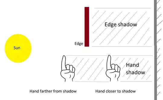

Edit 2: Here's a picture of the setup: Setup for this question.
When your hand is closer to the shadow than the edge, your hand's shadow bulges towards the edge shadow as the two get very close. When the edge is closer to the shadow than your hand, the edge's shadow bulges toward your hand's shadow.
