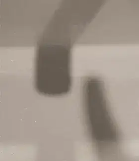

I have recently noticed that when two objects with blurry shadows cast by the same light source are brought close to each other, their shadows appear to merge in a way where one shadow appears to "bulge" and meet the other even though the two objects are not in contact. I noticed this in my bathroom while I was brushing my teeth. Here is a gif of the same:
Blurry shadows merging
I thought that this might have to do with diffraction (although diffraction is a phenomenon that only occurs when light meets objects that are of size comparable to its wavelength, which is not the case here) or the umbrae and penumbrae of the blurry shadows but I'm not sure.

I was also able to easily recreate this effect using my table lamp, and found that the object that is further from the light source seems to be the one whose shadow "bulges" outward towards the shadow of the object closer to the source of light. This agrees with the gif above as my finger in it is closer to the bathroom light than the faucet, which is the one whose shadow appears to bulge towards the shadow of my finger. It also seems that the blurrier the shadow (i.e. the closer the object is to the light source), the greater is the "bulging" effect although I have not thoroughly tested this.

While searching about this phenomenon on the web, I came across this Wikipedia page that describes it as the "Shadow blister effect". Although the page is pretty barebones and lacks citations, it seems to agree with my observations about the positions of objects with respect to the light source and each other, and suggests that:
The effect takes place when two objects are located at varying distances between a non-point light source and a backdrop upon which their shadows are cast. As the two objects move transversely such that their shadows approach each other, the object nearest the light source will begin blocking light from reaching the inside of the other object's penumbra, thereby expanding its umbra. This expansion of the further object's umbra will continue until the umbras of both objects meet. This effect can be demonstrated and understood using ray theory.

When something has a blurry shadow, the blurry part is called the penumbra, and it's there because the light source is larger than a point. If you're in the penumbra, you can see part of the light source peeking out from behind the shadow caster. The fully dark part is the umbra. In the umbra, you can't see the light source at all.
If you think about it, the larger the light source, the smaller the umbra (the dark part) is. That's because some of the light from the part of the light source that sticks out the farthest angles back inward and illuminates area that would otherwise be in full shadow (i.e., in the umbra). If you shrink the light source, the umbra gets bigger.
So think about what happens when an object close to the light source moves so that its shadow overlaps the shadow of a farther object. From the point of view of the surface on which the shadow is cast, the moving object (the one closer to the light source) is effectively making the light source smaller. So the umbra (again, that's the dark part) of the object farther from the light source gets bigger just where the moving object's shadow is.
