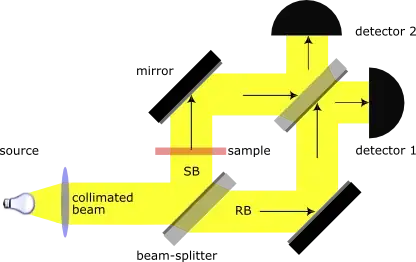

I think a good way to approach this question is with a Mach-Zehnder interferometer:Mach-Zehnder interferometer
The field landing on detector 1 is the interference between two waves, one from the lower path, and one from the upper path. Let's suppose the field in each arm is a collimated beam of coherent light, well-approximated as a plane wave, and the interferometer is well-aligned, so the two outputs are almost perfectly overlapped. By changing the thickness of the sample, we can change the relative phase between the two waves, changing our interference from destructive (less energy on detector 1) to constructive (more energy on detector 1). Where did this energy come from? If the beams are nicely matched, this interference can even be completely destructive, and detector 1 will register zero signal. Where does the energy go?
The short answer is: detector 2. The total energy hitting the two detectors is constant, as you vary the phase shift caused by the sample. Constructive interference at detector 1 goes hand-in-hand with destructive interference at detector 2.
If you only look at one detector or the other, it might seem like energy is created or destroyed by interference, but as other answers mention, we must consider the whole system.

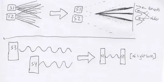

This figure shows two common situations.
The top is an example where the waves are coming from different directions--one from "S1", one from "S2". Then there is destructive interference in some areas ("nodes") and constructive interference in others ("hot spots"). The energy has been redistributed but the total amount of energy is the same.
The bottom is an example where the two sources S3 and S4 are highly directional plane-wave emitters, so that they can destructively interfere everywhere they overlap. For that to happen, the source S4 itself has to be sitting in the field of S3. Then actually what is happening is that S4 is absorbing the energy of S3. (You may think that running the laser S4 will drain its battery, but ideally, the battery can even get recharged!)
