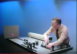

Here is the set up, at the point where it is arranged that the beam on the left is the one returning to the source.
setup

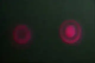

From a larger distance interference fringes appear
interf

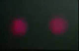

Here are the two beams , the one returning to the source(left) and the one coming from the source (right). The interferences are complementary.
bringing the mirror closer concentrates on the central spot
two

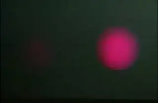

The instructor ( Shaoul Ezekiel) presses on the table to change the wavelengths, and force total destructive on the right,
right
and then total destructive on the left
Please note that I am making screen shots of the video. I advise you to watch it.
