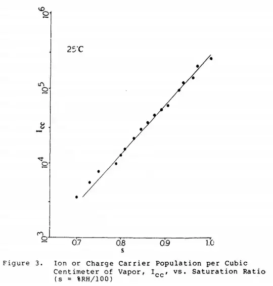

The question then becomes - what is the major contributor to the conductivity of the air? A 1988 research report by Hugh R Carlon, Electrical properties of atmospheric moist air: a systematic, experimental study had the following in its abstract:
All results are consistent with the view that ions are produced in moist air [...]
Reproducing figure 3 from that paper:
you can see that they measured a charge carrier density that is logarithmically dependent on relative humidity - and charge carrier density scales with conductivity (all other things being equal).
This is the reason, incidentally, that most ESD (electrostatic discharge) damage occurs in winter: when the air outside is cold, the relative humidity inside (where it is warm) will be low; thus the conductivity is low, and objects have a chance to build up charge without it leaking away so quickly.

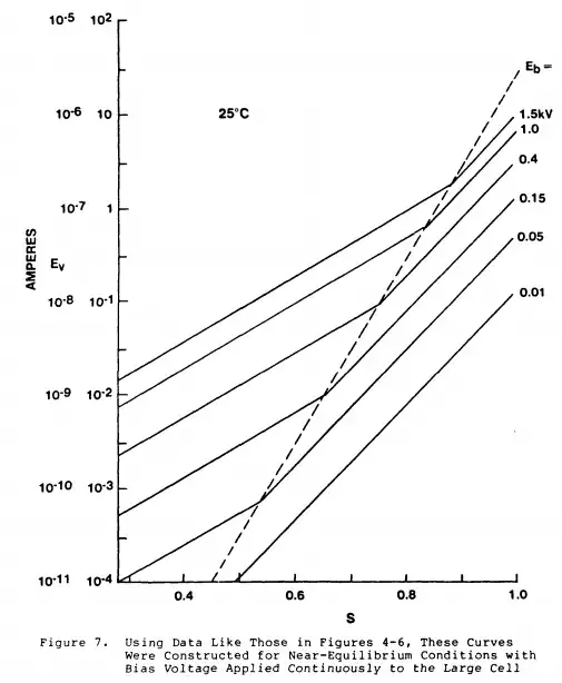

One more figure from the same paper, showing the discharge current measured for different voltages, at different levels of humidity. Once again, it is hard to escape the conclusion that ionization of moisture in the air is responsible for the conductivity (and thus for the discharging of your statically charged comb):
