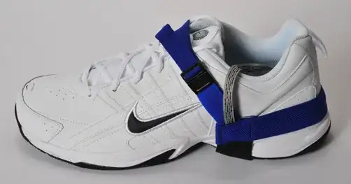

As for "how to prevent": in environments with sensitive electrical components the floor is usually treated with a (slightly) conductive compound, and people wear a heel strap that connects their skin (around the outside of the shoe) to the floor - see this image from ultrastatinc.com:
They also wear a conductive wrist strap that is grounded at the workstation (usually with a high resistance in series, so if they touch a live part they don't get electrocuted).
