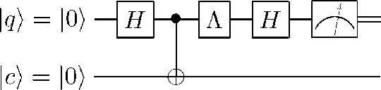

II. Which-way information destroys interference
Now imagine that we want to copy the which-way information: Then, what we do is
this is, we copy the which-way information before traversing the interferometer onto qubit $c$. It is easy to see that this destroys the interference pattern, i.e., $\mathrm{prob}(0)=1/2$.

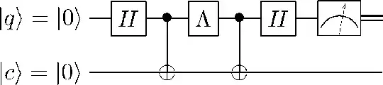

III. Unitary erasure of which-way information
Finally, if we want to erase the which-way information again after traversing the interferometer in a unitary fashion, what we do is
It is again easy to see that (since $\Lambda$ is diagonal) this undoes the effect of the first CNOT (i.e., erases the which-way information), and thus, we will observe the interference pattern again.

The procedure is described by the following circuit:
Here, we copy the which-way information onto the qubit $c$ before traversing the interferometer. After the interferometer, the $H$ makes the two paths interfere, and we measure. Note that at this point this is nothing but the procedure of part II and thus, $\mathrm{prob}(0)=1/2$. (In particular, there is no interference whatsoever observed.)
