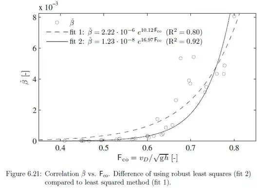

$F_{co}$ combined Froude number, [dimensionless], and can be calculated $F_{co}\thickapprox v_D/ \sqrt{gh}$
where $v_D$ is intake velocity, [$m/s$]; $D$ being the intake pipe diameter.
$g$ is gravitational constant, $9.81m/s^2$
$h$ is intake submerge (w.r.t. axis) [$m$]
The set up can be seen in this picture (page 68); Air core vortex lab setup
With the "Air Entrainment Hook" is Ment the sudden rise of air Entrainement rate $\beta$ (page 136);
Air core vortex, air entrainment hook
$\beta=Q_a/Q_w$ where $Q_a$ discharge of air and $Q_w$ discharge of water [$m^3/s$]

Physical explanation of the "air Entrainment Hook" at $F_{co}=0.7$?

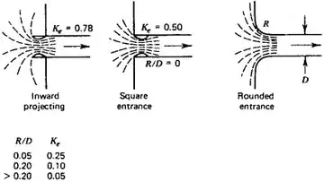

From the picture in question, it can also seen that the Vortex ends some distance inside the pipe, instead of ending at the entrance. Further it can be noted, that vortex is already disturbed, but still existing before it's totally broke in single bubbles. The reason for this is the velocity stack at entrance; picture below;
Pipe intake losses
At the intake, the flow area is pinched down, due to the flow conditions in this particular experiment.
