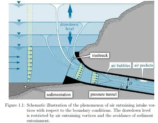

According to Heimholz second theorem it goes all the way. It even can't end in the fluid. You of course mean just the air, but it's merely a matter of how the situation is developing. If the flow conditions goes over Froude number 1 you will allways have the connection. It's explained here; Air core Vortex; Physical explanation of the "air Entrainment Hook" at $F_{co}=0.7$ -on my answer.
And according to experience gathered at hydropowerplants it really goes "all the way." Here is a nice study about the issue see ie. picture in page one.
Note that the pressure in intake is not the same, and "all the way" is the connection between two pressures.
